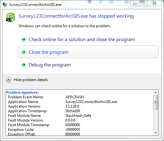

When I try to open Survey 123 Connect I get an instant crash. I haven't ever been able to get Survey123 Connect to run on this computer, but it runs fine on my Windows 10 machine.
As soon as I launch the app from the start menu or the .exe file, I get the crash in the image attached. I've tried uninstalling and reinstalling multiple times and can't seem to find a solution online for this issue. If you have any advice regarding this, it would be greatly appreciated.

TimothyCondon
Hello Philip,
I'm running Windows 7 Professional and Windows Update is up to date.
I tried running the .exe file using the workaround "C:\Users\{username}\Applications\ArcGIS\Survey123ConnectforArcGIS\Survey123ConnectforArcGIS.exe --renderingEngine angle" but that failed as well.
I'm starting to believe my problem may be with the graphics built into my work computer. I've attached an image of my graphics diagnostic and to me it seems like it may not have a hardware acceleration driver that is functioning correctly. I updated my graphics drivers but am still seeing no improvement.
My colleagues have DirectX functionality and have graphics cards that are working so I'm going to be contacting work IT and seeing if they can assist me further in this. If you have any other suggestions, I'd greatly appreciate them.
