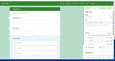

This morning, I was demoing how to create a new form in Survey123 using the Web Designer. When I added a question to the form, I wasn’t able to edit the question text. I tried adding a second question to see if that would help, but the same issue occurred, and I couldn’t edit either question.
My coworkers are experiencing the same problem. We’ve tested it in different browsers and on different machines, but no luck.
Is anyone else running into this? Could this be a temporary bug, and is there a known workaround?
Thanks in advance!

I have added a "single line text" question type and the question's label does not change when I type in the text box. The same thing happens for the "single select" question type also; the label doesn't change but the choices do. Previously, it was not letting me return to the first question but thankfully it did this time.

We got it to eventually work in incognito mode. There were no new extensions, but I am assuming a cleared cache is what was needed.
