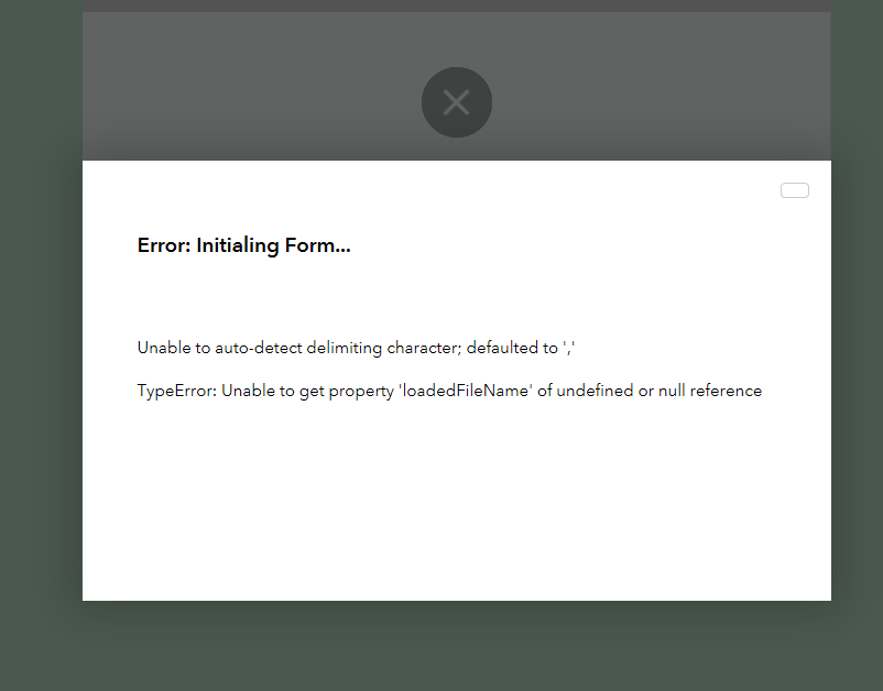

I have a survey123 form and it works (so far) well in the mobile app on iOS, the same form however on the Web Browser app in IE and Chrome fails to load with an error while accessing the content of a .csv file
this is the IE file error
The error in chrome
Chrome ErrorThe auth.csv below  file is as example - it only has commas as the delimiter....   I'm using this calculate on a username Type to lookup the csv file find a user and update their Authority field.
pulldata('auth','authority','name',${username})

Hi Jonathon,
I had a look at your survey and csv file, and the issue appears to be caused by an extra line that exists in your auth.csv file. If you open the csv in a text editor (such as Notepad++) you will see an extra line that has no data in it (line 10). The field app appears to ignore this null line, but the web app is more sensitive to this null line:
After I remove this line the web app loads your survey correctly without error.
Phil.

Hi @DataOfficer ,
I took a quick look at your survey and csv files and can see the problem. Two of the csv files you are using for pulldata @ csv only have one column in them. This causes a problem, as the web app does a check to see what type of delimiter is being used (comma, semicolon, tab etc). As there is only one column there are no delimeters, hence the error.
I see that you are using the pulldata calculation as follows:
pulldata('SiteCodeList','SiteCode','SiteCode',${SiteName})
Where the SiteCode column is used twice, both the input and output. Pulldata is not really designed to work this way, there should be at least 2 columns in the csv file.
That being said, an easy way to resolve this is to duplicate the SiteCode column, call it something else, ie put a 1 on the end, and it works fine:
pulldata('SiteCodeList','SiteCode','SiteCode1',${SiteName})
You will also need to do this for the AreaCode column in the other csv too:
pulldata('AreaCodeList','AreaCode','AreaCode1',${AreaName})
