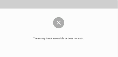

I created a survey yesterday but it doesn't seem to be accessible to anyone even in my organization.  It is all shared to public access on both arcgis online and the survey123 collaborate tab.  I'm stuck because after looking at some of the other posts here I verified that everything is in the same folder inside of a group.  When users try to access it they get this error:
Sharing permissions:

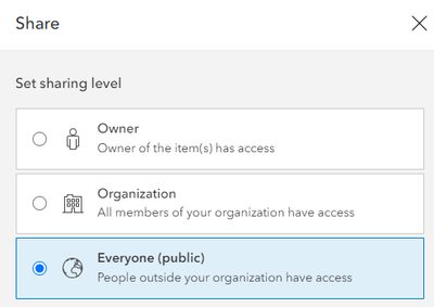

That is the third picture in my post (might be hard to see because it's small).  Under the "Collaborate" tab is the sharing option of "Who can submit this survey" and it is set to "Everyone (public)"

Yes.  I opened the survey (it works fine for me which makes me think something in the sharing permissions is off - but I checked it against another survey we have that is working fine and it's identical).  I copy and paste the link that works for me (logged in on Chrome) into Edge and it gives me the same error (not logged in).

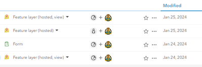

In AGOL when you adjust sharing permissions you're given these options, currently ALL layers (including the parent layer for the moment) are set to this same setting:

There is another setting I think.  Double check all the steps in post I linked.
