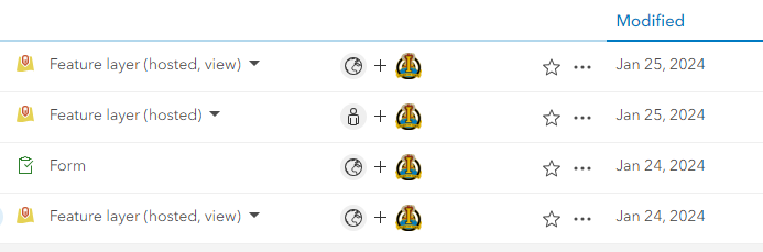

I created a survey yesterday but it doesn't seem to be accessible to anyone even in my organization.  It is all shared to public access on both arcgis online and the survey123 collaborate tab.  I'm stuck because after looking at some of the other posts here I verified that everything is in the same folder inside of a group.  When users try to access it they get this error:

I do not, I am not a great coder.  This is built strictly off the blank template.  I am reluctantly going to re-create the survey from scratch to double check all of my settings.  One thing I do notice that seems off is when clicking the "Share Survey" button from the top menu I usually get a shortened link and with this survey I do not.  I get the feeling something on the back end during the creating went wrong.  I've never seen this type of issue before with any other survey I created.
The painful part will be going back and reconnecting all of the dashboard elements that were tied to it :'(

Well, even the new survey is having issues.  I guess I have to do some digging and see if if's a survey123 issue.  No other surveys that I have are producing this issue (started this morning).

Have you renamed survey form or folder that it was created in?
Renaming the folder/file/layers, moving content between users/folders, can break the ability of the survey to function. It will typically work OK for the owners but not other users.
The survey form needs to be the original name in a folder of the same name i.e. Survey-Surveyname.
GEO_SARGE
This had to have something to do with it.  I tried to add the items to a group and it wasn't working.  I started another new survey this morning and it it finally worked.
