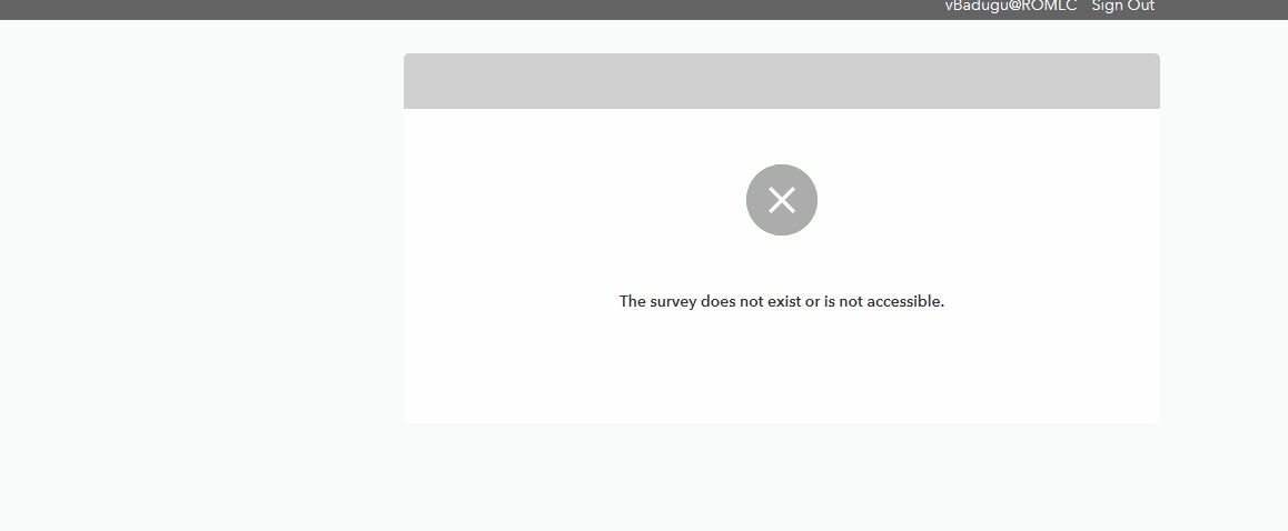

I try to open Survey form from Survey Connect using online button and it shows as below . i tried to open URL with PortalUrl and it shows same . whats wrong with this ? I checked the similar errors in the Geonet but did not help
The issue with Internet explorer and it is opening fine in Chrome browser . I am using IE Edge

Hi Vijay,
Are you using Internet Explorer (IE11) or Edge? These are two different browsers, does one work and not the other?
Are you using Portal or AGO? If you are using Portal what is the version and is your Portal public facing? Is the survey survey public or does it require signed in user? Can you provide a copy of the URL you are trying to use?
That error would indicate that the itemID of that survey in the URL does not exist, it is not found on the Portal, or the user that is currently signed in does not have access to that survey via the sharing permissions?

It is working fine with IE 11. the problem with EDGE IE. I am using ArcGIS Enterprise 10.7.1. it is public facing
https://gistemp1.romlc.net/arcgisportal    And IWA . The same item id is working chrome and IE11

Thanks for the additional information. This is known issue that has been identified previously. If you have an IWA Enterprise portal that is public facing and share a survey publicly, it will not work as expected in all browsers. The error and behaviour in some browsers is different to others, but underlying issue is the same.

Yes, there are known issues and limitation with IWA and Enterprise and the Survey123 website, web app and feature reports. Please see the Limitations section here in the Survey123 online documentation: Use Survey123 with ArcGIS Enterprise—Survey123 for ArcGIS | Documentation
