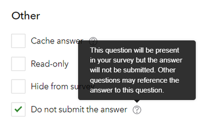

The author of the Survey form would have chosen the following option, while designing the form.

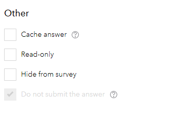

I am the creator of the survey and I see this box checked, but it is greyed out...
JayantaPoddar
MVP Alum
Once the survey is published, this option is greyed out. You could delete the question, and create a new question without selecting the option.
