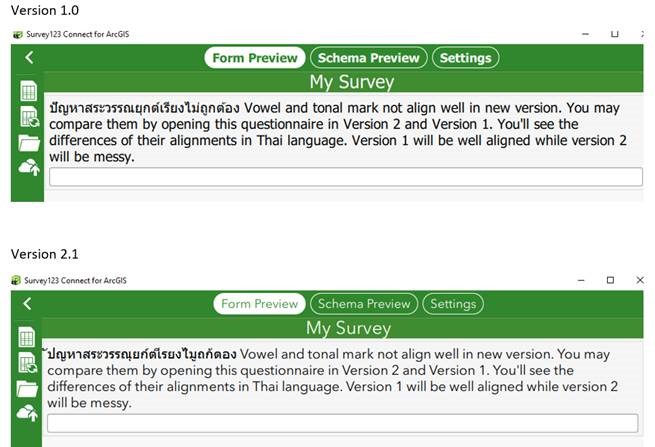

Survey 123 field app and Survey 123 Connect can not display Thai language properly.  Before upgrade to version 2, both applications can display Thai language correctly.  I change locale to Thai already but it doesn't seem to work.

It happens to both Windows7 and Windows 10.  IOS and Android can display correctly.

Both Survey 123 connect version 1.10.43 and Survey 123 field app version 1.10.25 have no problems on Thai display.  The vowel and consonant are aligned correctly.  However, the upgrade version of Survey 123 version 2.0.41, 2.1.9 and Survey 123 field app 2.0.53 can not display Thai properly.  The vowel and consonant are not aligned anymore.comparison between version 1 and version 2 for Survey 123 connectComparison between version 1 and version 2 for Survey 123 field app

Hi amnat,
We have been able to reproduce the issue you describe, though I don't have any timeline for resolving it at this time.

Just a quick update on this. We are planning to make the fix to this problem available in our 2.4 release, which will be made available before the end of September.
IsmaelChivite
Esri Notable Contributor
Hi. 2.4 is now released. This issue should now be resolved. https://community.esri.com/groups/survey123/blog/2017/09/20/talk-like-a-pirate-release-24
