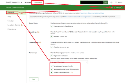

And have you checked your organization settings yet?

The templates link to AGOL items, can you access them?
Standard: https://arcgis.com/home/item.html?id=56aae92ae2ef48f4a001c56f0a4edeff
Advanced: https://arcgis.com/home/item.html?id=3db671560a72427b8d778a2da0979773
Are you able to access any from the Organization or Esri templates?
