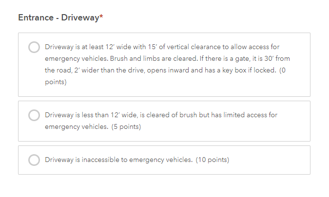

I have a survey with 16 questions. Each question is the Singel Select type with 2 or 3 answers. Each answer is given a score of either 0, 5, 10, or 15 points. What I want to do is set it up so that the points are added up and automatically populate a Home Assessment Score field with the sum of the points (somewhere between 0 and 130 points). I also want it to automatically select the Home Assessment Rating field rating (0-25 = Low Risk Hazard, 26-50 = Medium Risk, 51-100 = High Risk, and > 100 = Extreme Risk.
Any suggestions would be appreciated, thanks!
Link to Survey here.
Question example:

At this point (I built this via the Survey123 web tool) the value being stored is the answer selected. See the example I posted the screenshot of. I am not that familiar with customization of the table via Survey123 Connect. Like, is there a way to associate the needed points for each possible response and then create a script like you suggest selecting the number selected?

Switching to numeric values would be much simpler. But to answer your question, it would be simple enough to have an object in JS in which the answer and its point value act as a key/value pair.
var q_points = {
  "First Answer":  5,
  "Second Answer": 10,
  "Third Answer":  0,
  "First Answer but to a different question": 5,
  "and so on": 10
And then you could use the value of the question to pull the points. Assuming you included your answers on the JS function as parameters like "q1", "q2", etc, it might look like this:
var the_sum = q_points[q1] + q_points[q2] + ...
return the_sum
