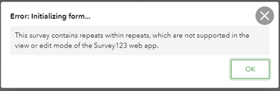

I have now hit a second issue. I have nested repeats (My point feature class links to a table which links to another table). I added the Survey123 form I created with the relationship class ini it into a dashboard so I can edit the features. However I get an error when I update the Survey123 URL in my dashboard to add ?mode=edit ' - 'The Survey contains repeats which are not supported in view or edit mode of the Survey123 web app. Is there an alternative way that I can update the survey within ArcGIS Online?
FrankOuyang
Hi John, glad to hear that you have been making progress. To answer the question you have now, not all types of questions can be edit online at the moment. You will probably need to download Survey123 Connect to edit it on a desktop machine to access the full edit functionalities, as explained here
