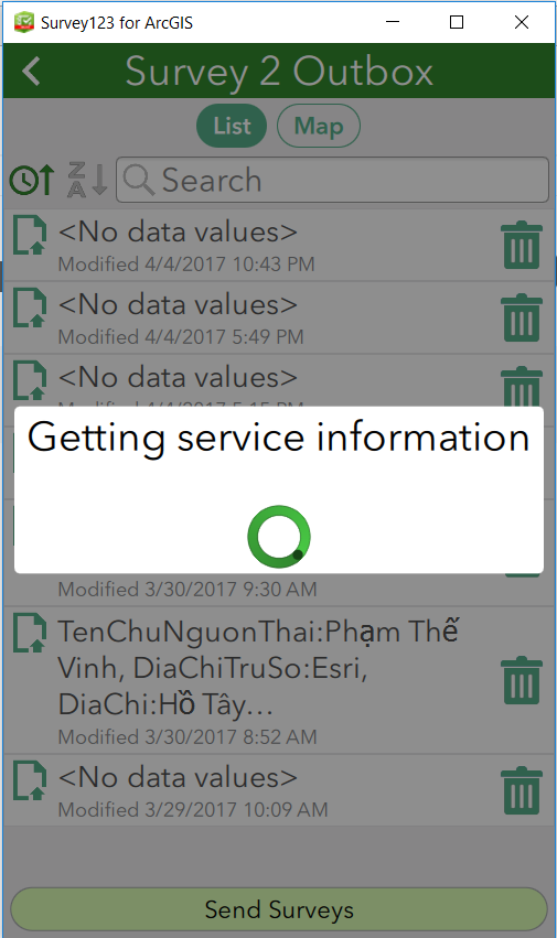

Hi guys! I have a question related to submit survey data with portal 10.5, I get "Getting service information" hang on on screen. Actually, I saw on : What's new in Survey123—Survey123 for ArcGIS | ArcGIS , this bug is fixed. And when I use with portal 10.4, it ok. But with portal 10.5, it still error.
Submit survey data

Hi Nguyen,
What release of Survey123 are you using?
This error might be related to a bug seen in these other threads:
Hope this helps,
NguyenBang
Hi Derek Law!
Thank you for your reply! I found a ploblem in my question, may be it happen when I create XLSForm, update and publish again. With a new survey form, it ok!
