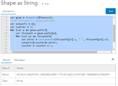

AprilChipman
James - I've been trying to get this to work in my data, but cannot get the custom url to pass the geometry of a line to the survey. It's passing other field attributes, so I know the url syntax is working.
When I test the 'Shape as String' expression I get really weird values. Could this be my problem? If so, how is it coming up with these coordinates and how can I make it stop?
