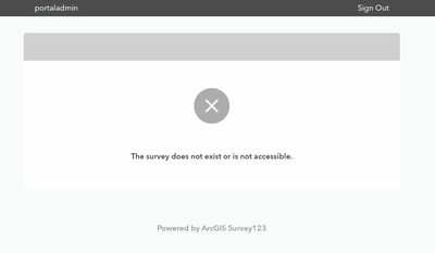

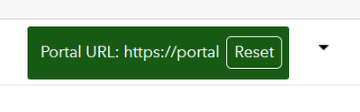

Thanks for the reply.  I have uninstalled, and reinstalled, add the 2 IIS variables and installed a reverse proxy.  The URL is now accessible from any machine via authentication.  However, when we authenticate we get the following error:
 It seems as the URL for the portal isnt being stored correctly.  After the user authenticates the portal URL changes to the screen shot below and then the error that was depicted above.
