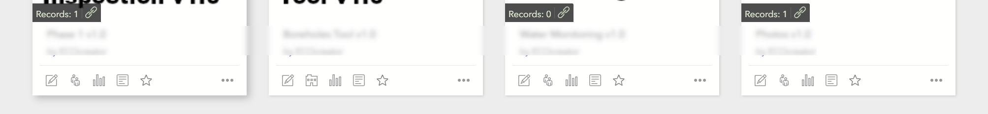

I'm not entirely sure what is going on.  I have lost access to one Survey from the https://survey123.arcgis.com/surveys page.
On that homepage, no records overlay appears like it does for every other survey.

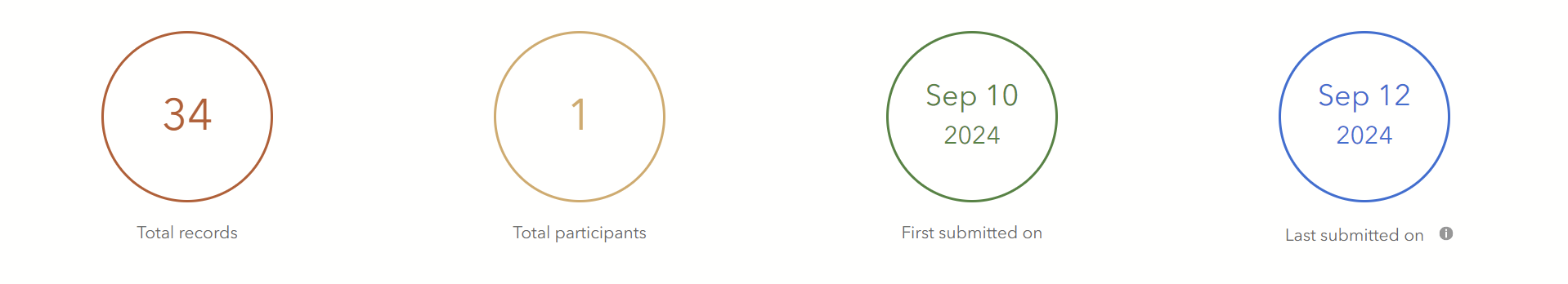

When i open it I can see there are records:
But the data tab tries to load forever without success.  And the Analysis tab gives me this:
