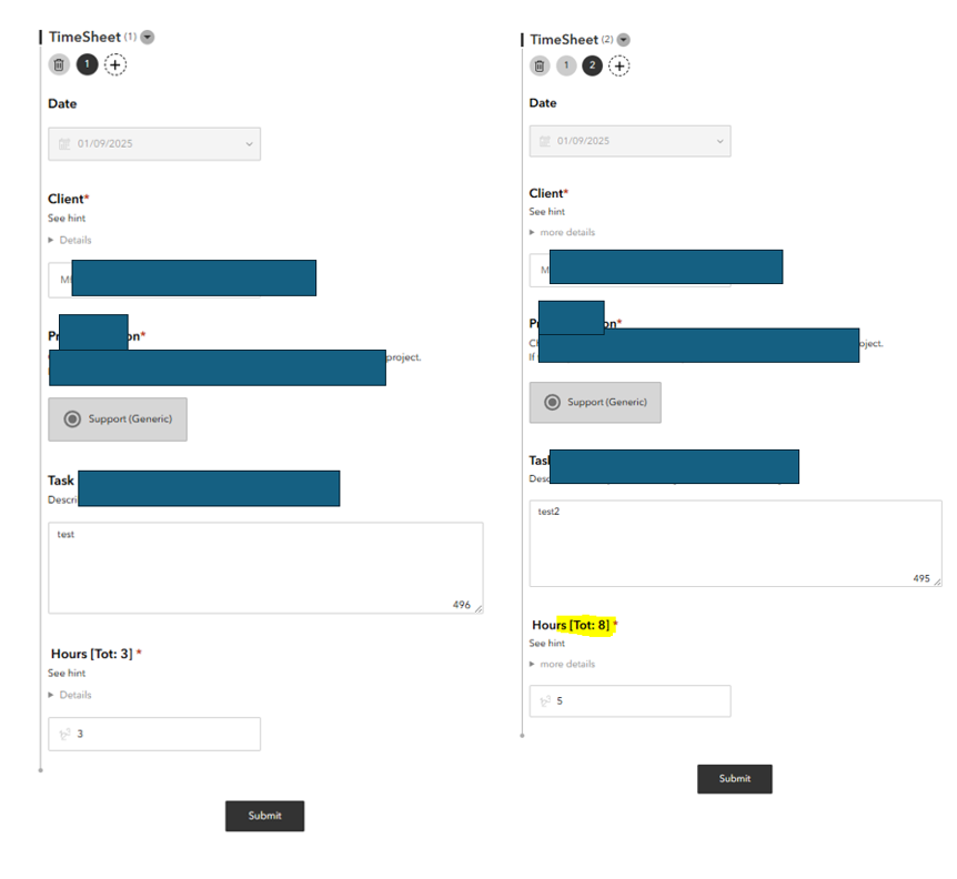

Hello!
Strange behavior but since I do not use webForm that much I am not sure I made something wrong.
I have a survey123 that collect data and it is embedded in a web experience ap.
I have a repeat that can be filled as many times as needed.

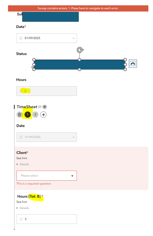

I filled the first, I move to the second, I press submit and the form goes back to the first repeat because is empty
only the hours seems to be retained (the total is still there), everything else is deleted, and I have to refill it, this happens even with more repeats, all those before the last one lose the info.
This does not happen on the Windows mobile app.
Any clue? Thanks!

Hello Pan,
Just for your information—I have a very similar workflow (a survey embedded in Experience Builder with several repeats-Web-Form), and I'm not experiencing the issue you're describing.
In my case, I have a select_multiple question that's populated using a dynamic list via search appearance, and none of my questions are set to required. Even when I submit the repeat without filling out the first entry, the subsequent entries are still captured correctly.
Hope this helps as a comparison!
