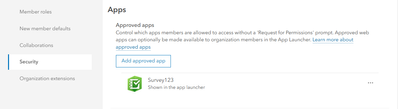

Hi @vijaybadugu,
Could you try going to your portal organization settings > Security. Then, add Survey123 as an approved app in your portal?
https://enterprise.arcgis.com/en/portal/latest/administer/windows/manage-app-launcher.htm#ESRI_SECTI...
