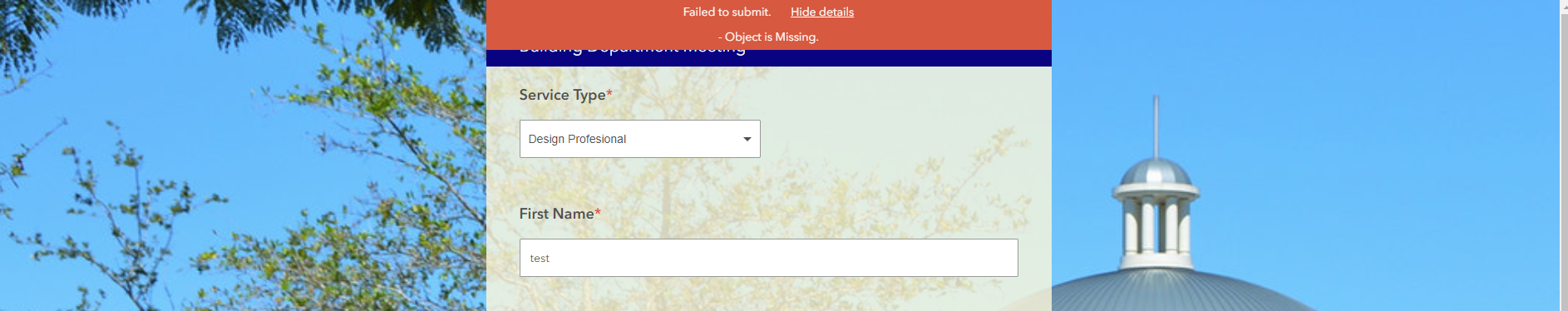

Hello,
Please see screenshot. There is an error/fail. It is Survey123 Web Browser from AGOL. It is happen only when to submit with an attachment. Please assist on this matter as soon as possible. Thanks
"Failed to submit. Hide details
  • - Object is Missing."
cc: Survey123 for ArcGIS
