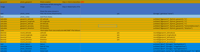

LukeSwanson17
Hey Christopher,
I appreciate the reply.
I have done other work arounds such as using a geopoint to populate the lat, lon, alt fields; then those fields are inputted into the watermark. Attaching a photo of this specific work around.
I have tried using the pulldata("@exif",${image},"GpsAltitude") function but my theory is that it pulls that exif data after creating a watermark on the photo. Result is the watermark is missing the information, but the altitude field still gets populated because of the pulldata calculation. It seems like it's just how the order of operations work in this situation?
