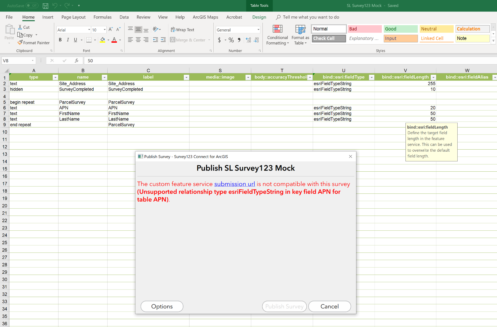

I used ArcMap 10.6.1 to publish a feature service to AGOL for a polygon layer that contains an APN field and some other field data not needed and I have a stand-alone table with a APN field and blank rows for fields FirstName and LastName. I used ArcCatalog 10.6.1 to create a relationship class between the polygon layer and table based off the APN with a 1(parcels)-Many(APNs table). I am trying to create a survey from Survey123 Connect for ArcGIS version 3.7.62 and create the survey from the feature service option since I uploaded the parcels and table to AGOL.
One of the questions comes from the polygon layer with the field called “SurveyComplete” and it updates a polygon based on if the answer is “Yes” or “No”( making it green if Yes or no fill color if No). We are trying to create the survey to have multiple responses on each parcel a 1 (parcel) to many (related Table), since many surveys can belong to one parcel. Not sure if this is possible since I am trying to get a field answered with a Yes in the polygon layer and I want other questions answered in the related table to store separate information. I keep getting this (Unsupported relationship type esriFieeldTypeString in key field APN for table APN), please see below and attached is the survey XLS form. Can anyone please lead me in the right direction.

From your description and screenshot, it appears your feature service is using the 'APN' text field for the relationship.
To work with Survey123, relationships must be based on Global IDs.
Please find feature service prerequisites and other useful info here: Use Survey123 with existing feature services—Survey123 for ArcGIS | Documentation
And also described in this detailed blog: https://community.esri.com/groups/survey123/blog/2017/09/25/working-with-existing-feature-services-i...
Hope this helps.
Cheers,
Jim
