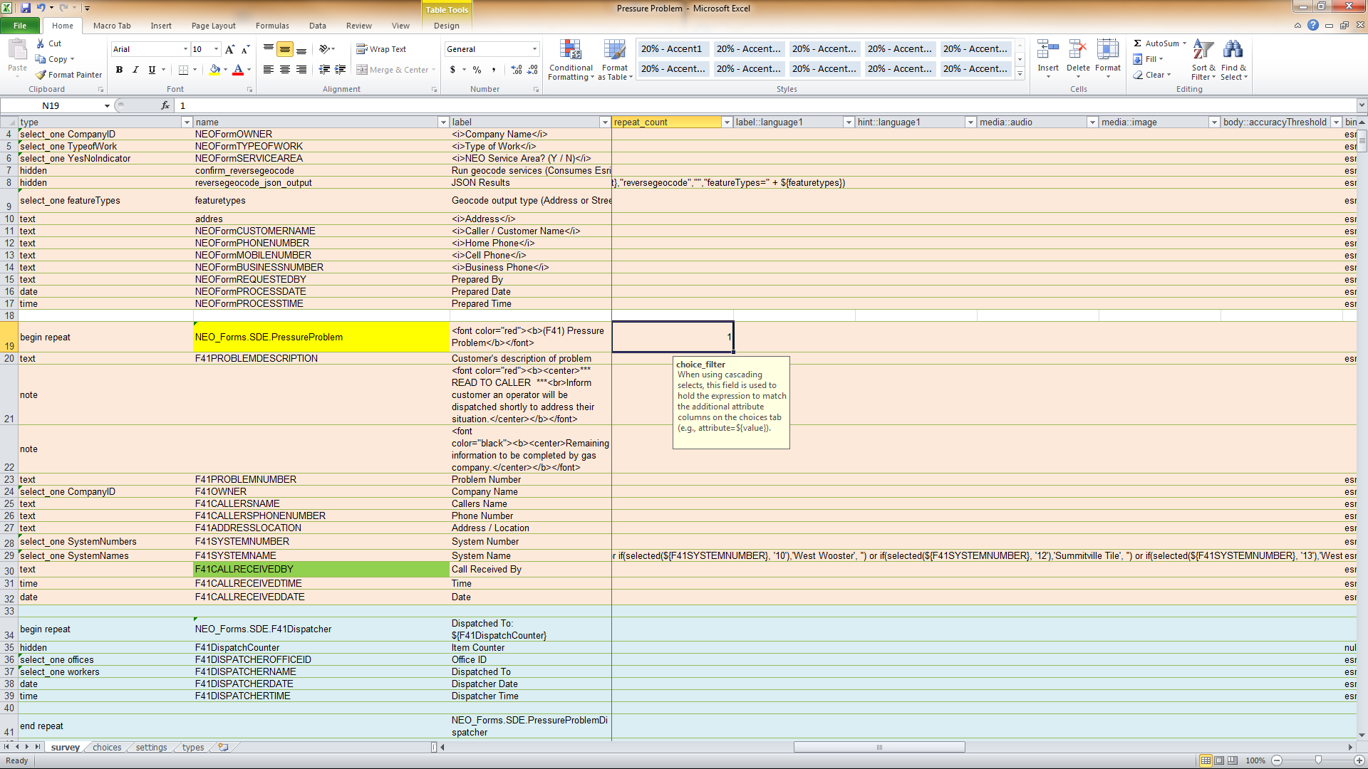

When we add a numeric value to repeat_count for a "begin repeat" there's an error being generated with this build release. We've never had issues prior to this release.

Thanks for the reply! It's a strange occurrence because that error only generates when a value is placed in the "repeat_count" tab. Keep it blank and everything passes with flying colors. Older versions don't prompt an error so I believe it's build specific.

I see what you mean now, Jordan. I had misunderstood your question on the initial read-through. Your question seems similar to one that was posted previously: Survey 123 - Repeat Count not allowing to publish form . It looks like the repeat-count setting requires a field in the parent layer in order to work properly. Not sure if this is exactly the issue you are having since you mention that it is specific to the Connect version you are on, but wouldn't hurt to check the Schema preview to see if maybe the repeat count is trying to add a field that doesn't exist in your service.
