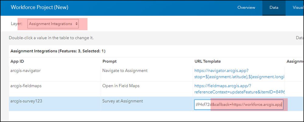

MJBiazar
Hi @MeghJones , Although Workforce allows certain configuration for the integration URL through the web app, you can modify the integrated URLs for any of the apps that your Workforce project is integrated with by editing the "Assignment Integrations"  table in the hosted feature layer for your project.
In this case, to add a callback parameter to the URL to return to Workforce app after submitting the form in Survey123 app, you can append "&callback=https://workforce.arcgis.app" to the URL.
