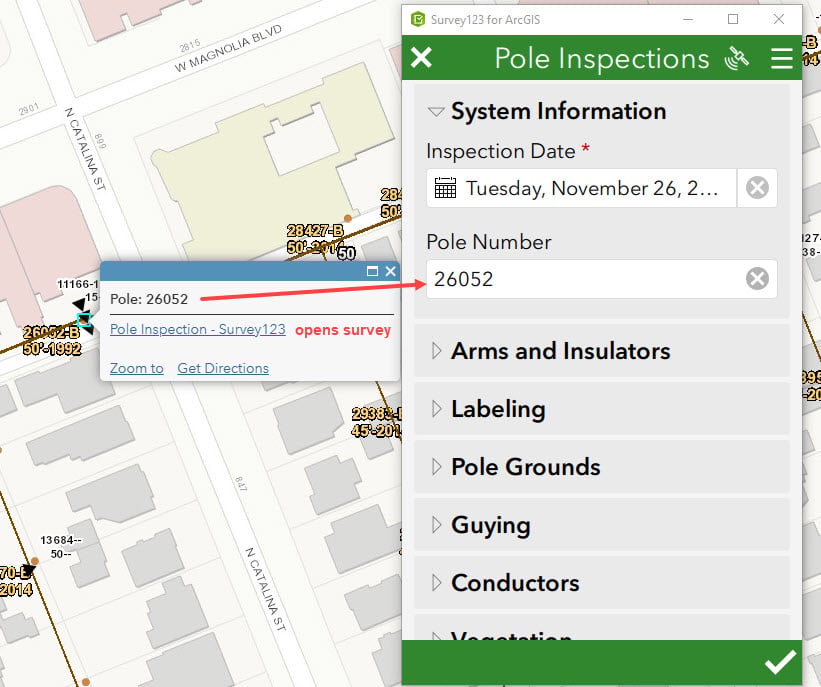

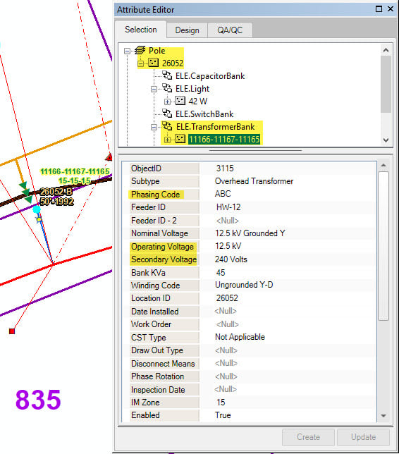

If I am doing a pole inspection in Survey123 and opening the survey by selecting the pole feature from another web app as well as populating attributes of the pole within the survey, is it possible to populate attributes of a feature that has a relationship/related table to the feature that is selected?  In example shown below, I would like to populate attributes not only from the pole, but from the transformer as well, such as phase, voltage, etc. Or if I was doing transformer inspections, populate attributes from transformer bank and transformer unit as well, etc. Make sense?

Hi,  thanks for your input. I tried what you suggested and it did not work.  I tried a url string with 2 features and also one with many features.  The only feature populating is the pole. Double checked that the naming convention is correct too. Here is the syntax:
arcgis-survey123://?itemID=c910f2c47e8a4af1a74c85a80807bacb&field:pole_number={FACILITYID}&field:oh_switch_number={relationships/3/FACILITYID}
