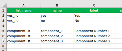

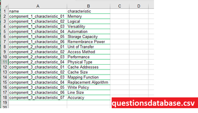

constellationshire
Here is an example of what I want to achieve:
Let's say I have this survey:
And my choices:
And the extra .csv to look what the actual questions are, since I cannot query the labels or hints with a formula:
The way this would work, is that I choose what type of component I want, and depending on that a series of attributes for each component will appear.
All of the "text" fields have a "null" bind::esri:fieldType so that they do not get captured on the survey.
I want, however, to capture the responses using a calculation.
1. Regarding the questions, it's easy because I can make a database and then run a pulldata based on a variable input (which changes based on the select_component)
2. Regarding, the answer, I cannot make something like ${VALUED IS BASED IN ${PREVIOUS VARIABLE}} type of field.
The workaround is to concatenate all the answers, each answer from a different component, what will result in the concantenation of empty strings and the string I want.
The reason I was looking at this approach is that I have a very large databse of objects and characteristics and I am running into the approximately 500 column limit, but a given component usually has 10-20 attributes to be recorded. If I can reconstruct the  questions and answer with a calculation, that would be great.
EDIT: wrong pics posted
