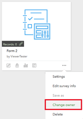

People in the Administrator role can see everything, but anything less than that (e.g., Publishers and Data Editors) can only see their own items. You can transfer a survey to someone else, but then only that person could edit it on the surveys website (unless the other editor was an admin):
Do you need them to edit the survey there, or could you set up a special survey specifically for editing details?
