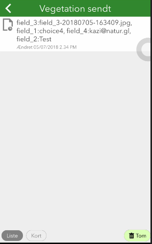

When the submitter use the Survey123 app for iOS or Android, their submissions including position, filled in information and photo are apparently transferred via WiFi  to the server according to the apps.

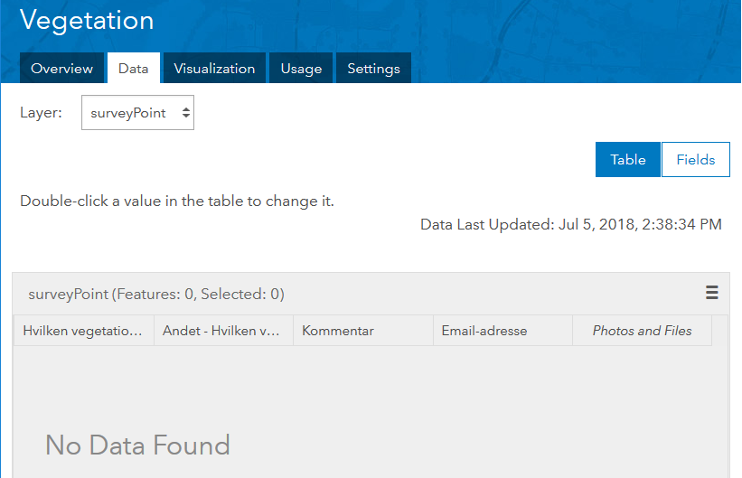

However, nothing shows up in the Data tab, so ArcGIS Online and Survey123 haven't received anything

In the Survey123 app for Android (downloaded yesterday, so recent version)
Results in the Data tab on the Survey123 website:
Results in AGOL:
