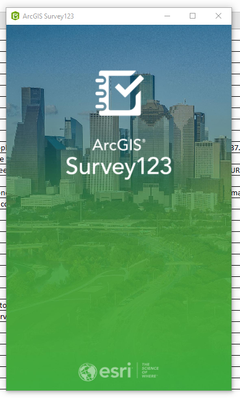

After we updated the portal to 11.1, my Survey123 is stuck at the starting page.
I uninstalled Survey123 and re-installed it, but it still stuck there. Does anyone know how to completely remove the app? Or directly go to the connections page?

Hello @YukoYokozawa
After uninstalling Survey123 navigate to C:\Users\<username>\ArcGIS\AppStudio\Settings and delete all the JSON files in that folder. This will remove all portal connections for both the Survey123 field app and Survey123 connect.
Then reinstall Survey123 to see if the issue persists. This may happen if the type of authentication changed on the ArcGIS Enterprise organization. For example, if the previous authentication type was IWA and is now using built in ArcGIS Enterprise log ins.

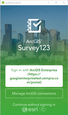

Thank you very much Zach! I was able to add the new portal. I have one question about it. I added the upgraded portal, and got this
The portal name doesn't show up on the button. I checked the portal settings and the name in the Organization Profile is set, but it doesn't show up on the sign-in button. Is this fixable?
ZacharySutherby
Hello @YukoYokozawa
If you access https://gasgisenterprisetest.sempra.com/portal/sharing/rest/portals/self?f=pjson in a browser on your network what is the value for the "name" attribute? This will likely be between "modified" and "notificationsEnabled" in the JSON.

YukoYokozawa
It's "null", if the one I found is right one

tbrownhome
Deleting the .json files and re-installing worked fine.  I had been stuck at the non-functioning splash screen, after uninstalling and reinstalling several times.  But deleting the .json files solved the problem.
