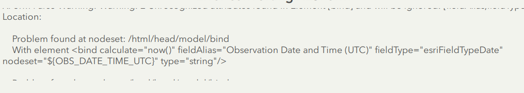

I'm starting out my new year by trying to build what should be a pretty simple Survey123 project. However, every time I try to build the survey I am receiving a strange error that I cannot resolve.
For context, I am using Survey123 Connect for ArcGIS (Version 2.3.24) and am using the 'Advanced' option.
Error as below:
The error is occurring on a couple of different fields. I don't think I'm doing anything too complicated - the fields I am getting issues on are:
1 - Record date / time. I would like this field to be hidden (using type = hidden), autopopulate with current date / time (calculation = now()). Using bind::esri:fieldType = esriFieldTypeDate
2 - Record lat / long of geopoint location. Both of these fields are hidden (type = hidden), calculation = pulldata("@geopoint",${LOCATION},"y") ("y" for lat and "x" for long). Using bind::esri:fieldType = esriFieldTypeDouble
The issue seems to relate to the bind::esri:fieldType column, as when I remove these values, the issue goes away. My understanding however is that as I would like these particular questions to be hidden, that I need to use this column.
Can anyone shed any light on this? Copy of the xlsforms spreadsheet attached for your reference.

Hi Anthony,
You are still missing a closing curly bracket on your calculation here: if(${ACTIONED_YES_NO}='yes',now(),'')
Because of this missing bracket, the pyxform validator is misreading the calculation and when progressing on to your bind esri field type fields it is throwing the error at that stage, but the root cause is actually the missing bracket in the calculation.
Phil.

Hi Anthony,
I had a quick look at your survey and noticed a few issues.
1. You are missing the now() function in Default column for OBS_DATE_TIME_UTC
2. Your calculation for COMPLETED_DATE_TIME is incorrect. It should be: if(${ACTIONED_YES_NO}='yes',now(),'')
Once you fix the above issues the form should work correctly. Your use of hidden fields and esri bind type parameters are correct.
Regards,
Phil.

Hi Anthony,
Phil.
AnthonyCheesman1
Thanks Phil - I would have been chasing that for weeks!
All seems to be working very well now, many thanks.
