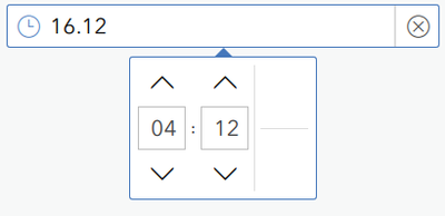

I am having a problem with the time input to my Survey123 Collector; the time spinner only displays 12 hours, and my client needs a 24-hour option. In the image, you can see 04 is represented as 16. I want the spinner to show 16.
On my Survey123 app, it works fine, and I have a tester in another country who uses the same Survey form on Survey123 Collector, where it also works fine.
My system clock set to 24-hours, and I have tried various configurations and running Survey123 Collector in administrator mode with no success. Does anyone have an idea what system or Survey123 setting needs to be changed?

It turns out this is a regional setting.
Survey123 does not recognise Region 'Denmark (Danish)'.
Changing my region to 'English (Danish)' fixed the problem.
