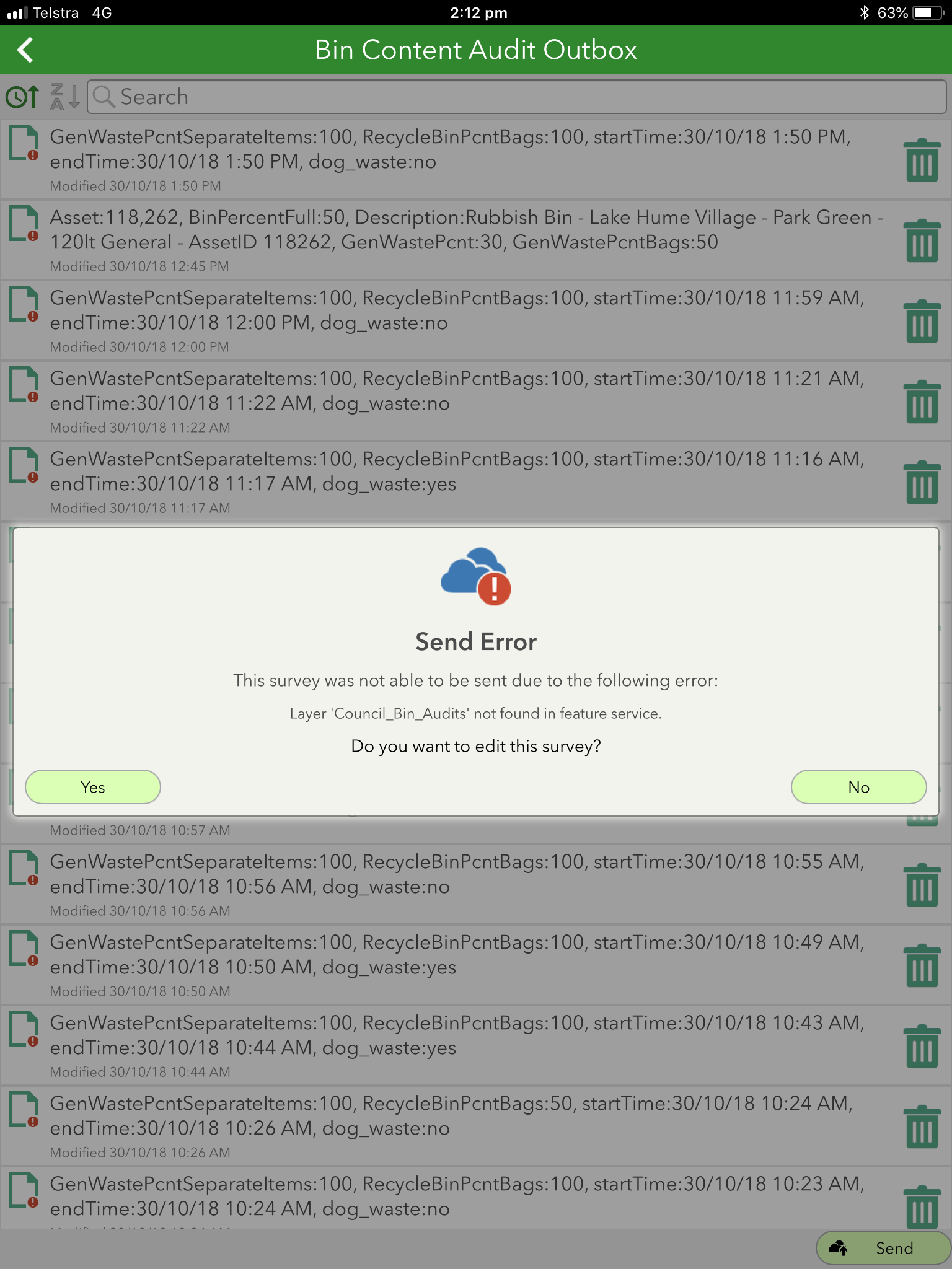

A fieldworker has reported and sent through this screenshot when they try to submit a survey form each time:

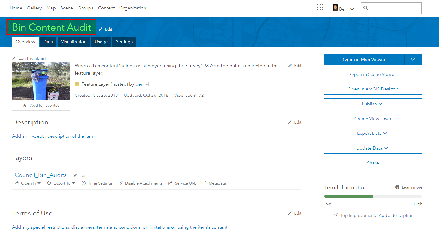

I see it is wanting to send data to Council_Bin_Audits. Is this talking about a feature layer? Like this highlighted area:

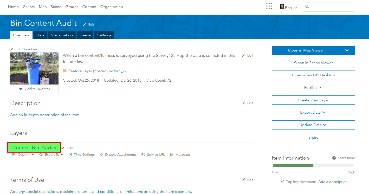

Or is it referring to this area:
I am thinking it is the latter.
NOTE: The latter is something I modified the other day (the day the survey stopped submitting correctly), and just now renamed to be 'Council_Bin_Audits'. But renaming it back to this has not fixed the issue. The survey is still throwing this same error.

man this was a simple answer I should have though of earlier... I signed out of the mobile device (both mine and the outdoor staff members), restarted both our devices, signed back into survey123 and both our devices uploaded the data without any issues... *slaps forehead*

RyanMiller11
I just had the same thing happen on v 3.12.  Logging out, closing app and restarting the device solved the issue.  Had spent about 2 hours troubleshooting similar steps as yourself.  I love Esri software.  It's the best.

I just want to add a note to others that may be wondering, I have since gone back and renamed the Layer from Council_Bin_Audits to bin_content_audit_data and I have since been able to submit survey forms with no issues. So renaming the layer does not kill survey forms (I was thinking this was the case, as this was the only survey form that had broken, and I had renamed a few).
