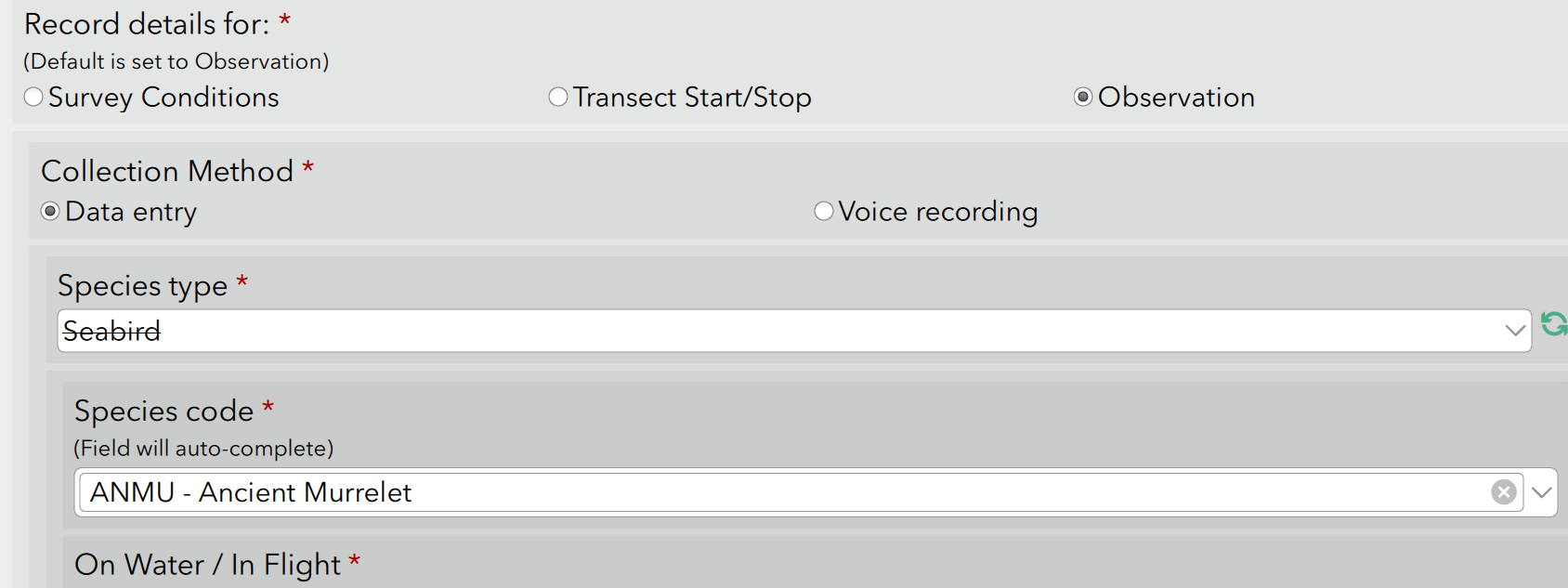

I have a strikethrough appearing in my selected options for a select_one drop-down. This happened quite suddenly but after I had made a number of small tweaks elsewhere in my template so I am not sure what has triggered it. I have had this issue occur previously with select_one options.
It occurs within a group within a repeat.

Hi. Are you running version 3.1 of the app? We have seen the 'strikethrough' issue in older versions of Survey123, but the last couple of releases addressed the situations that we knew of. If you are running on 3.1 and you still see the problem, it would be great it you could share the XLSFile.
Thanks!

I made a few more minor changes to the xlsform and the strikethrough disappeared. This was on Connect v 3.0.142. I'll update this post if it re-appears.
Good reminder to update to the latest versions!  Thank you!
