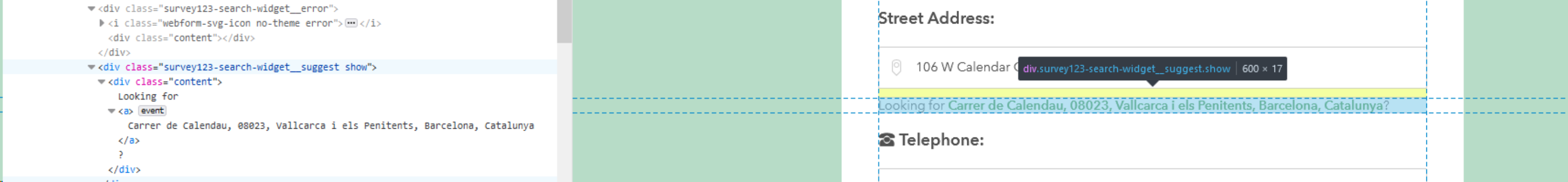

In the web form, when you select a business from the dropdown the contact info gets automatically filled out as it should, but then this suggestive text suddenly appears. I have no idea what's causing this. I used the FireFox dev tool to see what's behind this, and there is apparently a search-widget suggestion causing this. There is no need for this since I already have all the addresses I need in the CSV file. How do I stop this from happening?

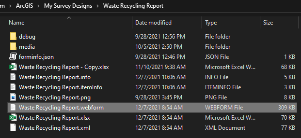

Edit: I've also opened all the sub-files in my survey folder-- C:>users>me >ArcGIS>My Survey Designs>
Unless I'm missing something, the only reference to the word "search" was in the *.webform file. And I have no idea if that's related.
            "id": "/Waste_Recycling_Report/intro/location1",

The "Looking for...?" prompt is occurring because the search text (the text that will be submitted for the address/geocode question) that is calculated doesn't exactly match any of the single line addresses returned from the geocode service, so it's asking if you would like to update the search text to the highest rated suggestion returned from the geocode service. In a manual entry scenario, the search text would be updated when the user selects a location from the dropdown list.
For example, for one of the company names in your survey, the search text that's calculated is "11 3rd St.", which isn't a 100% match with any location's address, so the prompt is asking you to confirm the location. If you changed the address in the CSV to "11 3RD AVE, JOLIET, IL, 60433", then you wouldn't get the prompt.

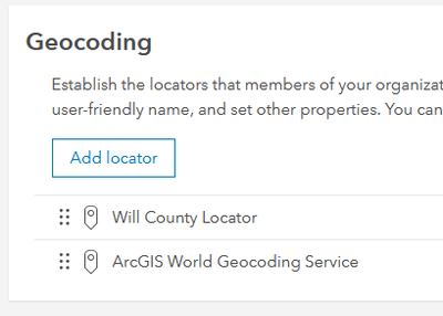

I suspected the geocoder. So, is my only option to change all the addresses the don't match what I'm assuming is the ArcGIS World Geocoding Service addresses? Or is there a way to change the geocoder? We have one we use in our maps and apps:
Edit: I've since found this tips and tricks doc that talks about geocoding. And our organization's geocoding utility service is already configured with a local geocoding service. The prompt suggestions, however, do not seem to honor the Will County service?

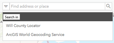

@BarbaraWebster1 It would be nice if you could add this in the geopoint question, so you could search in the map using your own organization's locator:
"geocode=<locator itemid>" in the bind::esri:parameters column.
UPDATE:  What I have suggested above works in the app, but not on the web form.

ArmstKP
@BarbaraWebster1 As of this morning, this seems to be working...
BarbaraWebster1
@ArmstKP Does this still work of you sign out and refresh the survey? I'm wondering if there might be custom locators set at the organization level since that's currently the only method for setting custom locators for geosearch listed in the Survey123 documentation
