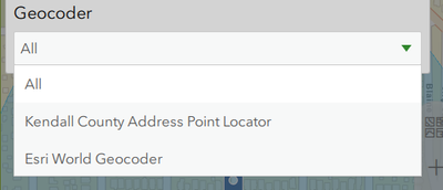

I believe the only way to do this is have other Locator services published to your portal. For instance, we have an address Locator specific to our county, and it appears as an option in the map. Our locator could as easily be based on, say, parcel numbers or neighborhood names. But it does need to be an actual locator.
- Josh Carlson
Kendall County GIS

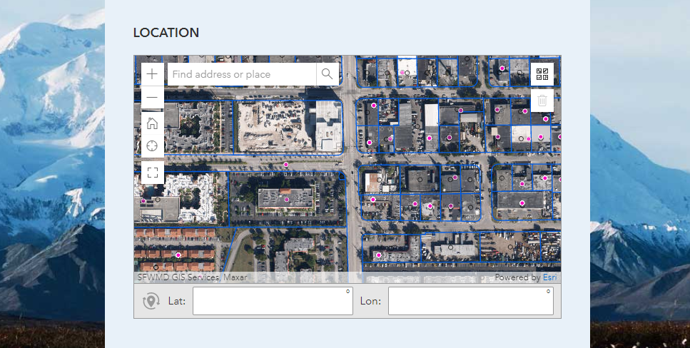

Once again, thank you Esri Community.  Just had a similar request for users to be able to search Park Names from a rest service and the geopoint appear at that location, that could then be adjusted.
Best way I could think of is to have a webapp, with the configured search and then have pop-up with a custom survey link and pass the location via url parameters.
Seems like over engineering the process, my suggestion is a custom basemap showing the parks in survey123
