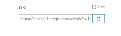

Does anybody know how I get the featureLayerUrl?
KerryKang
Hi Jose,
You can get the feature layer url on the layer's overview page. At the bottom right, there is a url you can copy.
Kerry
