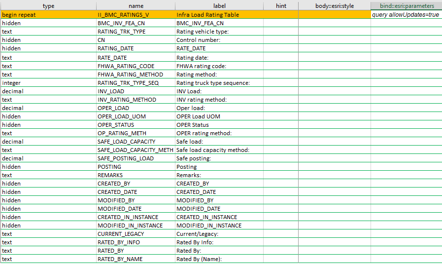

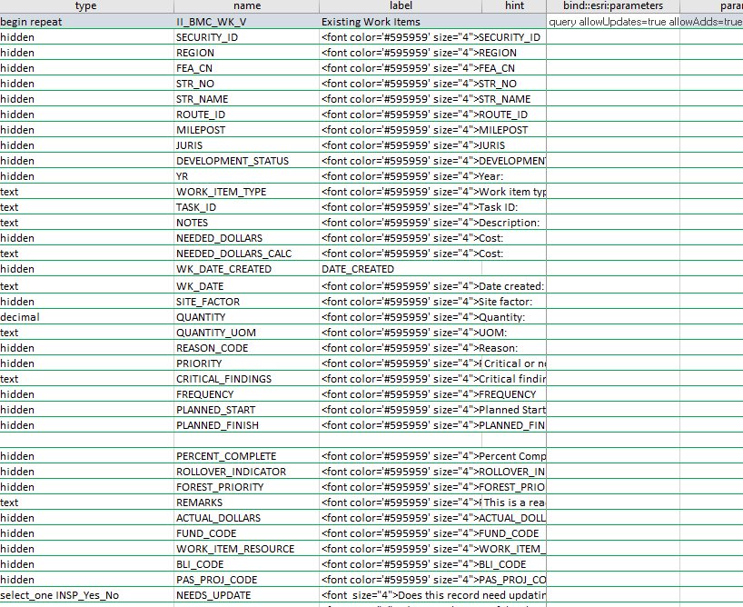

Here are how to the tables look in survey123 Connect:
Related Record 1Related Record 1Related Record 2Related Record 2

Now folks in the field are able to access all the prepopulated data from the survey in the inbox and submit the surveys just fine. Those two tables with read-only fields (II_BMC_RATINGS_V and II_BMC_WK_V) pull into the survey and submit. When I'm in the data tab, everything is there and connected. I can export the survey results to cvs or excel file and all the results, including those tables, pull in. When Form View is toggled on, those two tables populate in that window. The only issue is in the actual report word document/pdf.

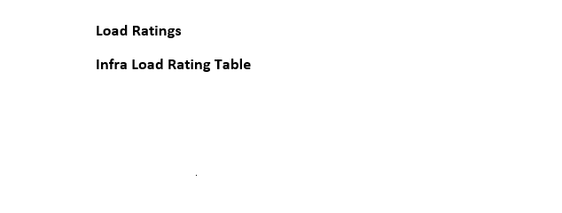

After downloading the "Individual Report" created by Survey123, this is is an example of what the first table looks like:
And this is what that same section looks like after running the report in Survey123 and downloading it as a Word doc:
The field names and fields are blank between ${#II_BMC_RATINGS_V} and ${/II_BMC_RATINGS_V}

In a copy survey, I've tried changing the esri bind paremeters to just "query" and changing the inbox settings to "Allow inbox surveys to be edited". I thought maybe the issue stemmed from that. It didn't work. I've double and triple checked the related table fields, but those are accurate and I don't get syntax errors when uploading my report. A coworker of mine helped me troubleshoot, and she was able to get the fields to populate in the Survey123-generated individual sample report, but not our actual report. For me, neither works. My only answer then, is maybe it's a Survey123 online bug?
