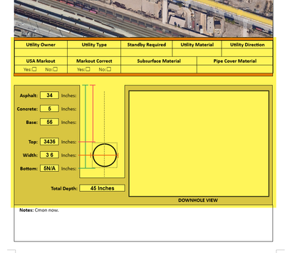

We are gettin close! I do have images that exist in those instances. I have updated my template using your doc and got past the errors although now the report has exported with no images and all the individual entries are being exported together on the same page entry. (I hope this makes sense)

I have checked with our developer if multiple ${imageQ} are written continuously, we may not be able to extract the template tags correctly. To fix the image exporting issue, please split multiple ${imageQ} with spaces or line breaks. Or you can use different font styles for them like the screenshot below:
I am not quite sure about "all the individual entries are being exported together on the same page entry". I guess you may want to repeat the highlighted section for each individual entry and I have included a modified template and an exported report for your reference.

Ok, the main thing I am trying to accomplish is if it's possible to DYNAMICALLY add pages when needed if a repeat is used in the survey. (Add another page for each repeat so we do not need a report with a bunch of blank pages if not needed). The section you have highlighted in yellow has a mix of info that IS and IS NOT contained in the repeat.

Sorry for the late reply. It is possible to dynamically add pages. Before the open tag ${#individual_entry} and close tag ${/} is the content that will be repeated for each entry.
So you can use:
Use field within repeat: ${dot1}
Use field outside repeat: ${$layers[0].pavethick}
page break
The generated report will look like this:
---On the page 1---
Value of dot1 in the 1st repeat instance
Value of pavethick
---On the page 2---
Value of dot1 in the 2nd repeat instance
Value of pavethick
---On the page n---
Value of dot1 in the nth repeat instance
Value of pavethick
Currently, you placed ${individual_entry} and ${/} in the same table cell, so the content between these tags will be repeated within this table cell only. The best practice is to use the open and close tag to wrap the entire section that you want to repeat for each entry. In my pervious reply, although I didn't produce the result your expected, you can still reference it to update your template.
