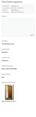

I created a survey in Connect off an existing feature service that is hosted in AGOL.  I added an image question allowing the user to upload an image which works great.  However, I am unable to get the image to show in the report.  I can see it in the Data tab of the survey.  I can see it in a web map in AGOL.  But when I generate a report nothing is there.
Report attached.

I created a "CRAWLSPACE_PHOTO" field but no data is in it. However, I can see the photo in survey123 under the "Data" tab.  I know the report uses keywords so I think its a syntax issue where I am just not calling the photo up correctly.
