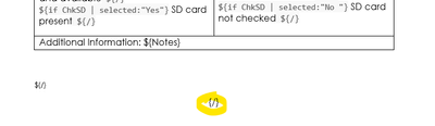

Hi @Ruth_JiatengXu  - I'm attaching the report template here.  I've stripped off the content from the parent feature, but the page #2 is where the repeat questions display.  Then the page #3 shows some more questions from the parent feature.  From your screenshot, it seemed I needed an additional closing tag.  But once I added it, it skipped showing the first repeat question altogether so I resorted back to using white font.  Attached template outputs something like this:
Ruth_JiatengXu
Hi @Anonymous User
I modified your template, and it should work now.
Few things to notice:
1. The following expression inserts a page break before each repeat, except for the first repeat instance. If you put the table between ${if ...} ${/}, then the table will not be printed for the first repeat instance.
${if ($feature|getValue:”position”)!=1} page break ${/}Observation
2. The ${if ...} ${/} needs the closing tab ${/} to work, and a space is needed between if and the expression.
3. If you only want to output the instance number without the if statement, you can simply use ${$feature | getValue: "position"}.
Thanks,
Ruth

I'm also having some trouble with this and I'm wondering if anyone here could help out:
I have a report that I want to print out only repeat data with a new page for each entry.
It starts with:${#repeat name}${if ($feature | getValue: “position”)!=1}, then has some MS Word tables with fields from the repeat, and ends with ${/}${/}
I feel like that should be working but I keep getting errors like Error: An error occurred when checking the report template. The tag beginning with "}$repeatEn" is unopened. The start tag ${# UASPreFlightChecklist} is unclosed.
Happy mapping,
- Zach
Ruth_JiatengXu
Hi @ZachBodenner ,
I am sorry for the late response. The close tag in your template might be the cause of this issue.
Thanks,
Ruth
