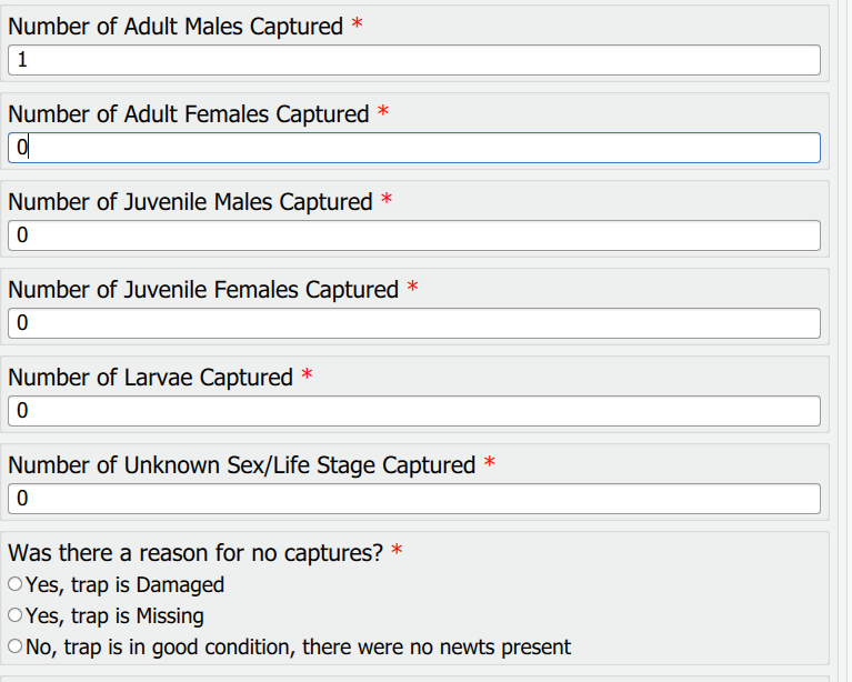

I have created a 'relevant' field based on a calculation of the previous 6 fields (i.e. the relevant field pops up if the 6 previous (numeric) fields are all answered '0' - "is there a reason for no results?").
The calculation and relevant field appear correctly in Survey123 Connect, Survey123 (desktop), Survey123 (Ipad) but the relevant question will not appear on my Iphone or on an android phone that I have tested.
Any ideas?
xls attached....

Hi Alana. I moved your question into the Survey123 group for higher visibility.  I made a minor modification to your survey, adjusting the relevant statement to use the calculate.
I tested the survey in an iPhone 6 and the relevant statement worked as expected. Please  make sure you have version 1.7.x (released last week), as this version includes a fix to relevant  statements that may be causing the problem you are observing.

I have made the change that you suggested and it does work on both my Iphone and Ipad
One thing to note is that it doesn't look like it is going to work in Survey123 connect!  When I input test data, the question is permanently visible, even when I enter an integer greater than 0 in one of the fields (I suspect may be why I had reverted to repeating the calculate in the relevant field rather than using the result of the calculate in the first place!!)
I am using Survey123 Connect version 1.1.19 for your reference
The most important thing is that it actually works in practice, so thanks for your advice!

1.1.19? That is pretty old and Beta!
Lets get you up to speed:
  • First download the latest version of Connect (1.7) from here: Survey123 for ArcGIS | ArcGIS
  • Second, update your Survey123 app. The latest version (1.7) is in the iTunes, Google Play and Windows  stores
Tip: We update Survey123 almost every month. Subscribe to this blog: Survey123 for ArcGIS  or to our account on Twitter: Survey123forArcGIS (@esriSurvey123) | Twitter
To learn what is new since 1.1.19 I recommend that you check this help topic:What's new in Survey123—Survey123 for ArcGIS | ArcGIS

Ah yes, I am up to date on my own devices (as I have control over those!) but the PC was lagging behind due to the need to get the servicedesk to update....
Sorted now and all is well
