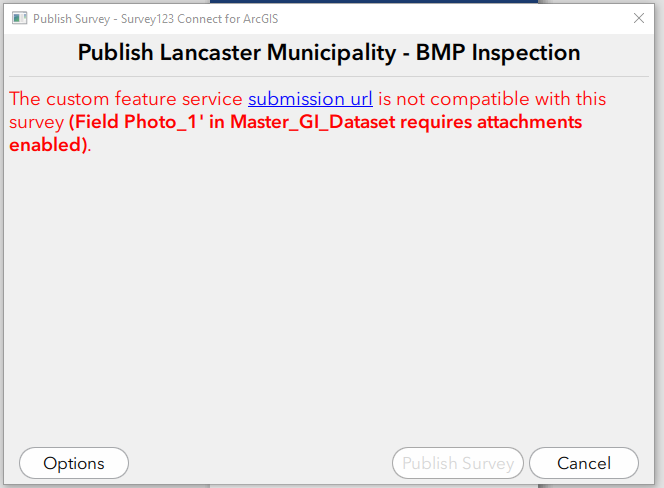

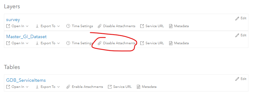

I've been struggling with what would seem to be an easy fix for far too long already. I'm linking a Survey123 form to an existing feature service on AGOL and after running through the majority of steps, I'm getting an error that says the submission URL is not compatible because Master_GI_Dataset requires attachments enabled. As you can see in the snippet below, attachments are enabled in that layer. Anything I can do to troubleshoot this? Any suggestions are welcomed.

Could you capture a log file of the publishing process?  That would help understand what Survey123 Connect sees when examining the feature service.

I figured this out, it was a simple issue. Basically attachments weren't enabled (nor the related attachments table) when uploaded to AGOL which caused a hangup with Survey123 even after enabling attachments on AGOL. Was able to solve it by reuploading.
