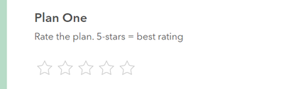

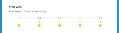

I was trying to stick with the web version of the survey designer, which doesn't give you that level of control.  The Rating question type in particular looks great when created with the web version, but you are stuck with the field format of String.  If you try to later edit that with Connect in order to change the field format to an Integer, the display of the question becomes less pleasing.
"Rating" question from web designer:
Appearance of same question after editing esribindtype to integer with Connect:
Connect doesn't seem to handle the "Rating" question type in quite the same way as the online designer...
So, under time pressure, I've just accepted that this is the way these questions have to look in order to get them to have an integer field type.

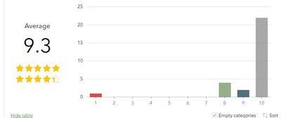

But AGOL can aggregate in Survey123 analytics, just not us in a Dashboard. Why?
