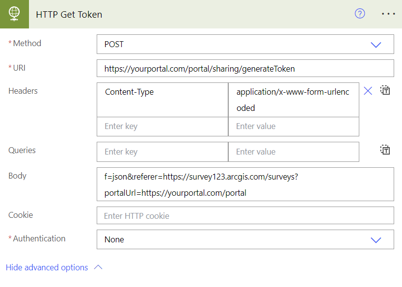

Dear All,
Does anyone know how to generate tokens from Survey123 using HTTP action using Power Automate?
I know that if I use the following as "body", I can generate a token without issues...but it against best practice.
username=USERNAME&password=PASSWORD&f=json&referer=https://survey123.arcgis.com/surveys?portalUrl=https://yourportal.com/portal

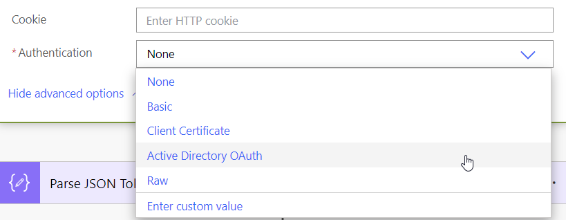

Any of the following authentication method will work? I tried "Basic", but it didn't not work...but return 400 error asking for username and password.
Are any tutorial or blog post regarding this? I need to generate "token" for public facing survey securely using Power Automate, since public facing survey will not have "token" generated for Survey123 "Create Report" action.
Thanks a lot!
Reno

Hi @abureaux ,
Thanks a lot! I think that I actually had no problems with "Create Report" but more is for processing "attachments" from submitted survey. My automation uploads them to OneDrive, and copy it to SharePoint Online. Survey123 attachmenrs in Microsoft Power Automate (esri.com)
Any solutions for requesting token securely without exposing credential in the body of HTTP (https) reqeust?
Cheers,
Reno
