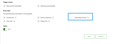

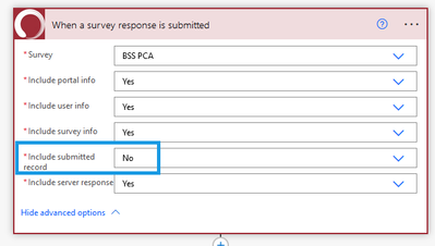

Have you tried disabling "include submitted record" yet?
You can also specify this in the Webhook in the Surveys Site:

Thank you for advising Premium does not resolve the issue. I have tried your suggestion thanks, but unfortunately this seems to prevent ObjectID or other fields being listed for the Report action. So I was stumped!
