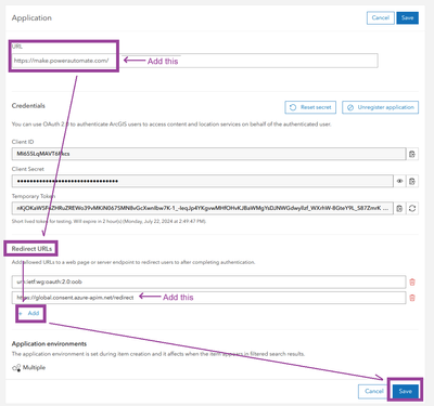

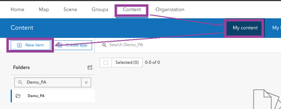

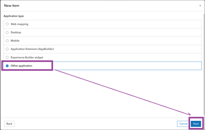

Part 1. Create App in Portal
  1. Content > My Content > New Item
  2.  Application > Other application > Next
  3. Enter a Title (Optionally: Configure the Folder, Tags, and Summary) > Save
  4. Settings > scroll down to URL and paste in https://make.powerautomate.com/ > scroll down to Redirect URLs > click + Add > paste in https://global.consent.azure-apim.net/redirect > click Save

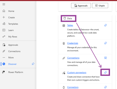

1. Load Power Automate and log in

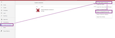

2. Look for "Custom connectors" on the left. If you see it, skip to Step #5, below. Otherwise, move on to Step #3, below

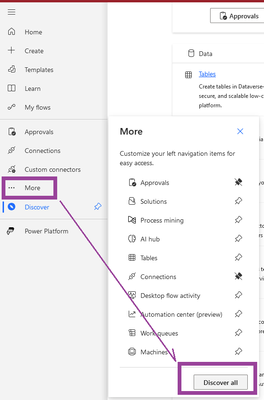

3. More > Discover all
4. Scroll down and look for "Custom connectors" under the Data group > click Pin

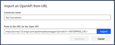

5. Custom connectors > + New custom connection > Import an OpenAPI from URL
6. Set Connector name to whatever you want > Enter a valid URL (see details below) into Paste in the URL for the Open API field
https://survey123.arcgis.com/api/template/swagger?portalUrl=<ENTERPRISE_URL>
<ENTERPRISE_URL> is the URL to your ArcGIS Enterprise deployment, including the web adaptor, for example, https://myserver.mycompany.com/arcgis
8. Click Import > wait for app to load (<1 second in my test) > click Continue once its available

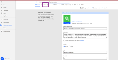

9. Click 2. Security

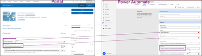

10. Copy over Client ID and Client secret from your Portal Application (created in Part 1), and copy Token URL into Refresh URL
It should go without saying, but don't use the values in my screen caps. That is my app created for this test, and it will already be deleted by the time anyone reads this.

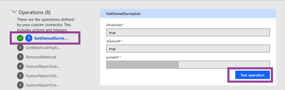

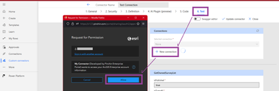

12. Click 6. Test > + New connection > Log in
13. Select GetOwnedSurveysList > click Test operation
14. Scroll to bottom of page once it finishes loading (<5 seconds in my test) > look for Validation succeeded
15. If you get this far, you are probably fine. You can follow the regular guide for the other tests if you really want, but it is a little out dated and missing content, so don't expect a 1:1
