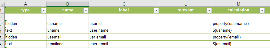

I am encountering a problem with the username variable being available in the field app but not in the webform.  Is that normal.  I am using the username variable value to check display fields and ability to post data.  I don't know why the two implementations appear to act differently.
A piece of the form is posted here,
I can't access the variable 'uname' in the web app.  Users must be logged in to view the form as it is shared to only certain groups. Any ideas?
JamesTedrick
Esri Esteemed Contributor
Hi Maaza,
Instead of using property('username'), I would recommend using a question of type username, which accomplishes the same thing. The property() function has been deprecated from the XLSForm specification and should not be used.

MaazaMekuria
Thank you, James.  The use of the username type resolved the implementation difference between the web form and the field app and loss of username.

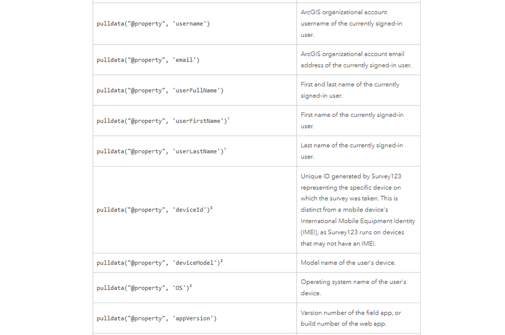

Update. A bunch of options have been added since this question was posted to make life easier.
Check the Device and user properties help topic here: https://doc.arcgis.com/en/survey123/desktop/create-surveys/prepopulateanswers.htm#ESRI_SECTION1_D526...
CatherineHall678
Thank you @IsmaelChivite for posting this...way easier!
