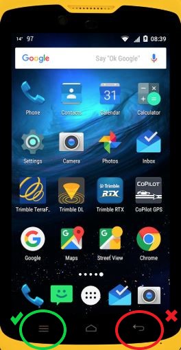

To follow-up, we determined that the workflow leading to a need to re-open the Survey123 field app each time the link containing the custom-url for the survey was selected from Collector included pushing the 'Android Back button' on the Android device as opposed to the 'Android Menu button'.
As a current best practice, it is recommended to use the menu button to access apps that are already open (i.e. when navigating back to Collector after submitting a survey from Survey123).  The picture below represents these buttons on the TDC-100.
