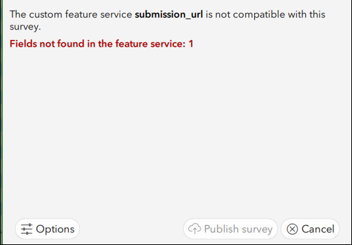

Often after making changes to our survey and republishing, we get the following error:
Fields not found in the feature service:1
Note:
1. No changes were made to the feature layer, only some coding in the XLSform.
2. Closing Survey123 and reopening, or cancelling a few times, the survey will publish.
Any ideas why this is?
ZacharySutherby
Hello @UlrichVanderHeyde
It looks like you are on an older version of Survey123 Connect. If you update to the latest 3.17.55 is the same behavior observed?
