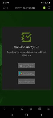

Thank you for your assistance on this. We are now able to use the survey. The only issue that we are still having is that instead of directly opening survey123 it first takes you to a web browser (see image below):
If you click on the survey123 icon it will open the survey. Is there a way to skip this additional step?

Strahanjen
Did you find a solution for getting the link to open Survey123 directly rather than going to the download page? I'm encountering the same issue.
GarrettBergey
Our issue actually went away. I believe that one of the ESRI updates corrected the problem. Good luck with your issue!
