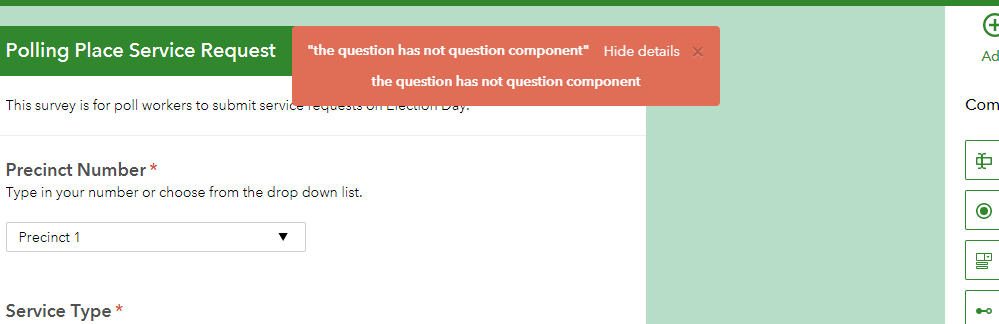

I'm building a Survey123 in the online builder, and at first it would let me save just fine. But now when I try to save, it just gives me the error "the question has not question component."
The details say the same thing. It's really strange, and Google hasn't yielded any results. I don't want to simply refresh, because I most likely will lose all changes since the last save.
I'm on google Chrome Version 65.0.3325.181 (Official Build) (64-bit)
Has anyone seen this error before?
EDIT: I deleted the last two of my questions just fine (and that didn't fix anything) but it won't let me delete my third-to-last question. I'm assuming this is the issue.

Hi Andrew,
Based on the error message you are receiving, it appears that one of the changes you did has caused the internal representation of the form to become invalid.  One of the ways to troubleshoot would be to remove the questions, most recently added first.  I also see that this message in particular can arise around the process of creating a new question by copying another- did you create any questions this way?

Hi James, thanks for the quick response! No, I didn't copy any questions. I'll try removing questions one by one.

I just deleted the last two of my questions just fine (and that didn't fix anything) but it won't let me delete my third-to-last question. I'm assuming this is the issue. I'm going to try refreshing the page and re-making the questions.
