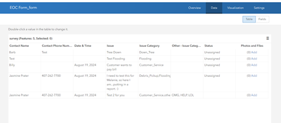

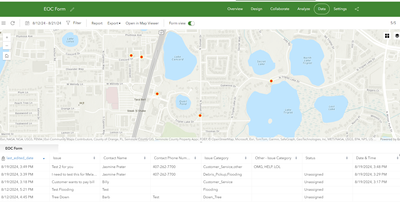

I have created a survey in the survey123 web designer and chose the date and time question and made it required and read only. When I click the data page, it shows the time captured in the field. However, when I view the hosted layer that it creates with the results it does not show the time only the date. I looked at the field type for it on the hosted layer and it says just date. I am assuming that this is the problem, but I don't know how to change it. We are currently on Enterprise 11.1. The first picture is the survey results inside of survey123 webdesigner. The second picture is the hosted layer it created the form_form version.

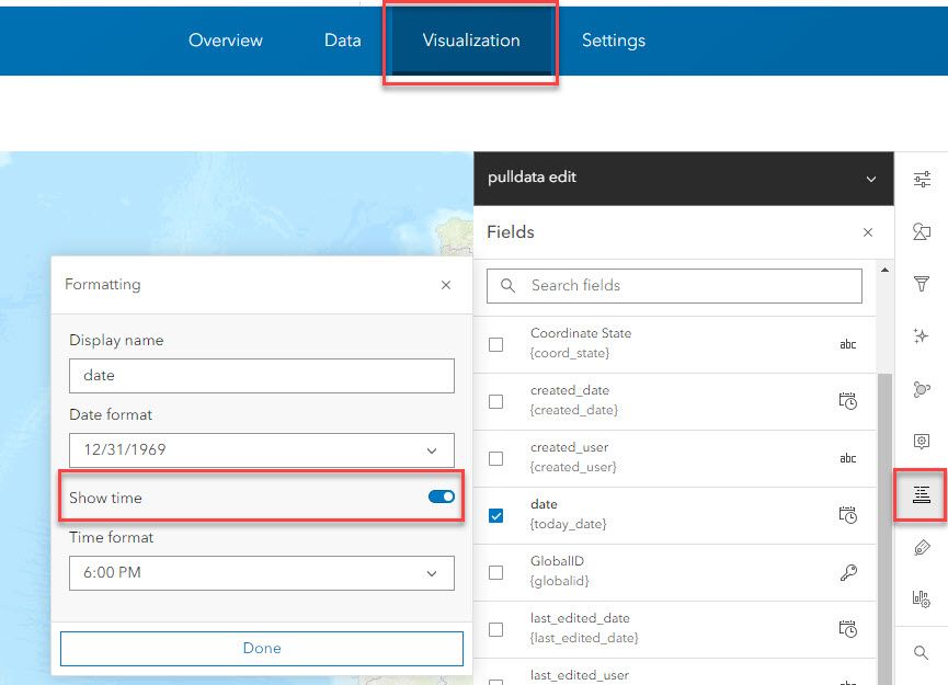

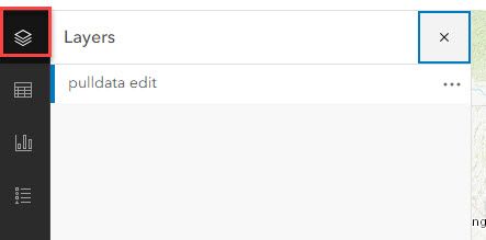

I think someone changed how the field is displayed for your layer.
From the Item Details page, click on Visualization.
Be sure you are on the Layers panel and your layer is selected.
Click on the Fields Icon in the right panel.
Click on your date and time field and ensure that Show Time is checked.
Save.

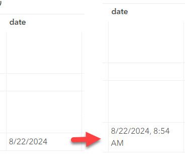

Below is the table view from the item details w/o and w/ Show time enabled.
- Jen

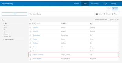

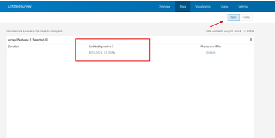

Hey @MelanieBass , I was able to do some tests on my end (in ArcGIS Online, not enterprise) and was not able to reproduce the issue. I see in the second screenshot you provided that there is a date_time field, I believe this to be the title of the question in the survey, as per my screenshot below, the question title for my survey was "untitled_question_3"
When I go to the "Data" tab, then click "Table" at the top right I do see the date and time fields populated correctly. If you do not see this populated in the table tab, please provide a screenshot of what it does look like. Thank you.

the ones that are missing it completely are correct. they didn't have that question in the survey when that submission was done.

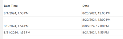

So, the Surveys Site does show time differently than Portal. The Surveys Site looks at the data type, and displays accordingly. The Portal doesn't seem to do that.
In this particular case, that means the Surveys Site displays only the date for date questions, and Portal displays date and time for date questions. In both cases, time is collected for date questions.

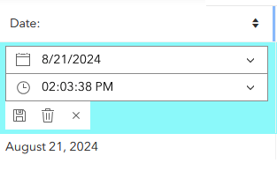

In the Surveys site, you can still see the time component of a date question by clicking into it:
Seems odd to me that time get recorded for date questions... It also occurs to me that I almost never use date only questions!

MelanieBass
OMG! Thank you so much for the help. I had no idea. I was beginning to think I was going to have to redo my work.
